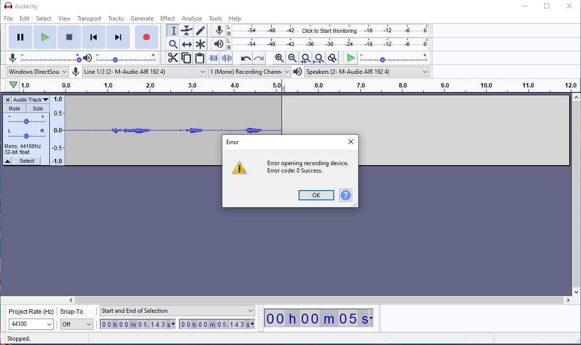

I’m trying to get the punch and roll recording feature to work. I’ve looked at the page for it and followed along to do everything correctly.
When I go to a place to re-record/punch in, I get this error message every time: Unanticipated Host Error. When I click OK to clear the error, it says: Error opening recording device. Error code: 0 Success.

SO, I went ahead and went into my Windows settings and you were correct, it was on 48000 hz. I fixed it for both playback and recording. Now audacity and windows are all at 41000 hz. It still was not working, so I tried switching between MME, Windows DirectSound and WASAPI. When recording with either, the recording is fine. Though, trying to punch and roll in all 3 produces different results.
MME: go to punch point, click shift D, it deletes everything after, but does not initiate the 2 second preview/record function of punch and roll.
Windows DirectSound: Go to punch point, click shift D, Original error of Unanticipated Host Error, Error opening recording device. Error code: 0 Success. It does delete everything after punch point.
WASAPI: go to punch point, click shift D, it immediately gives error opening recording device, error code -9997 Invalid sample rate. without deleting everything after the punch point.

I may have spoken too soon. It worked once. I double checked all the settings. It seems when I make sure everything is running on 41000hz, the playback tab constantly reverts back to 48000hz, even though I hit apply and OK.
Sorry for not being clear. It seems when I make sure everything is running on 41000hz, the playback tab constantly reverts back to 48000hz, even though I hit apply and OK. I then reboot. I check the playback tab again to ensure that it’s at 41000hz and it is. I open audacity, begin recording, then try to punch and roll. Still get the original error. When I go back into the playback tab, sure enough, the speaker has reverted to 48000hz.
From what you’ve said, it looks as though your 2- M-Audio AIR 192 4 really really wants to run at 48000Hz (or higher). Why fight it? I would set Audacity to 48000, the input and output speeds to 48000 and resample any tracks you are using to 48000 (after backing them up).
