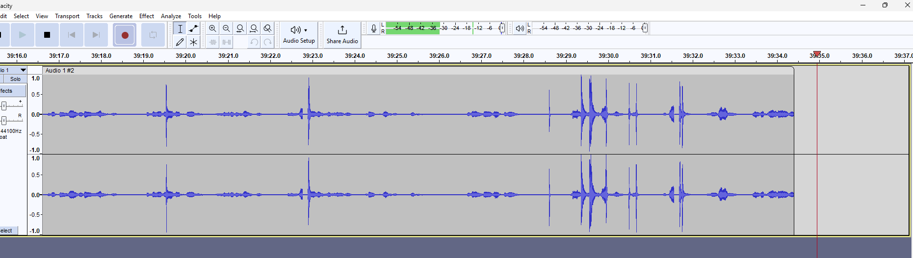

Not sure how else to describe it. Sound is normal. Sound going through system and coming out speakers in church sounds fine / normal. But after the sound goes through a bluetooth transmitter and is recorded in Audacity on a Windows PC, it has sharp cracks. This audio is then streamed through OBS, but the issue is present in Audacity. Issue comes and goes. I tried increasing latency bandwidth in Audacity. I tried reducing the sound coming in with the slide bar. Those did not appear to help. Any other settings I should check out? Thanks. Issues start at 1 minute in. More at half way point. https://www.youtube.com/watch?v=g1sCktFgaMI This is all the Audacity log showed: 09:03:32: Using internal LAME

The “spikes” (“glitches”) sound to me like bluetooth dropout. Try reducing the distance between the bluetooth transmitter and receiver - or better, look into replacing the bluetooth audio connection with a physical audio cable.
Steve and Doug, thanks. We will check those ideas out. I attached the flat line photo. I changed it to the one with the spikes, which you guys say are dropouts. I will approach some solutions with that in mind. Raise up the bluetooth transmitter and try to use a 3.5mm to XLR adaptor so the sound can go straight to the BlackMagic video receiver and not need the audacity program at all. Or try a different receiver. It is about 50 ft. But it worked fine for a couple years. Yes, we would prefer a hard line, but it is really far around the outside of the open church.
Moving the bluetooth audio receiver closer has reduced the sound drops. However, I had to use an XLR cable that was already in the wall. Going from 3.5 on bluetooth box to XLR to 3.5 adapter into Windows PC audio in, which Audacity receives. Now I have a -30dB hum on the line. Before it was -55dB and barely noticeable. -30 is noticeable. Would running a single 50’ 3.5 to 3.5 line reduce the hum of 3.5 to XLR to 3.5 50’? Not really a audacity question. Guess I’ll order the cable and try it outside the wall first. Thanks.
The XLR cable will be balanced and is very unlikely to be the cause of the hum. If I were you, my suspicion would be on the connectors.
