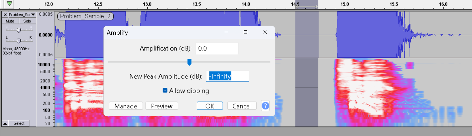

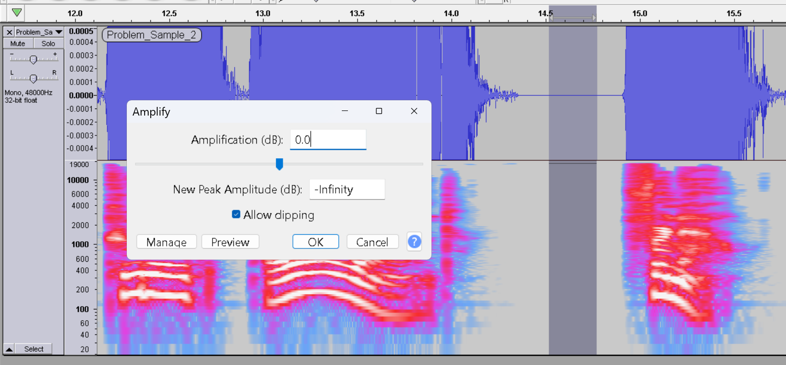

“-infinity” means a noise-gate has been applied to “Problem_Sample_2”: it’s not a raw recording
If the noise-gate is incorrectly set it can chatter, (buzz).
I confess that you have now lost me. I am unable to duplicate your screen shot, and every time I view the Amplify dialogue–either in v3 or v4, whether in the original file or the MP3–I do not see “-infinity”, but the typical “0dB”. Questions:
  • How could I have accidentally “applied a noise-gate”?
  • Can you explain “not a raw recording”? (I just recorded the same as I do every week without incident.)

There are short regions where the audio is digital-zero, flatline, nada …
That’s only possible with noise-gate.
The device you used to record the audio could have a noise-gate “enhancement”. Such enhancements can be on by default.
not raw = processing has been applied, e.g. noise-reduction, noise-gate.
