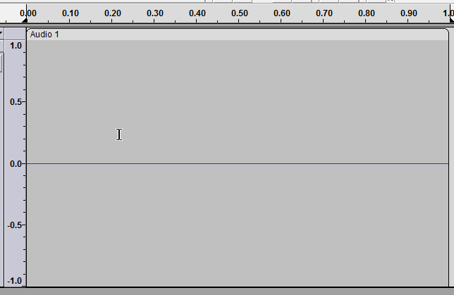

hzosc is enough to generate a sine wave …
sine gen nyquist
https://manual.audacityteam.org/man/programming_in_nyquist.html
Thank you for your fast reply.
But in my case it does not work.
If i understand the manuals correctly, the mult expression affects the amplitude (loudness) only.
So (hzosc 440) will generate a 440 Hz sinus signal with amplitude 1
(mult 0.1 (hzosc 440) will generate a 440 Hz sinus signal with amplitude 0.1
But in both cases the DURATION is 1 second only.
I want to generate longer signals than 1 second.
Then you need to stretch it:
(stretch 10 (hzosc 440))
or
(stretch-abs 10 (hzosc 440))
