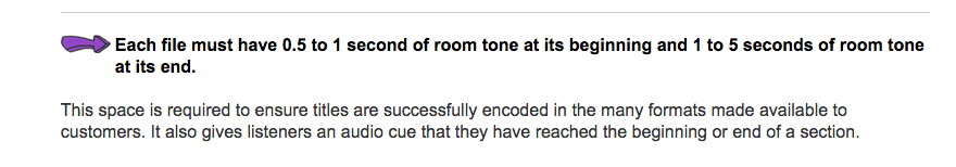

This is from the ACX web page of recommendations.
Note it does not say “dead silence before and after”. They specifically want Room Tone or background noise in those places.
That may have caused other problems as well. If the Room Tone segments are missing from your submission (the noise would, oddly enough, have been too low), then ACX would have tried to derive Room Tone for noise measurements from your performance. That’s likely to result in silly high noise readings and would have failed ACX Technical Standards.
