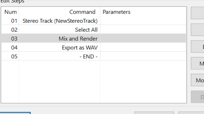

I was using 2.1, and now in 2.3.3 there is a “macro” feature.
So i just make new stereo track, select all and mix and render and does the batch perfect.
Here a screenshot of the Macro:
https://i.paste.pics/fed6e09b33c6bcd9b8a0b413886be0e1.png
I think your macro could be even simpler.
Exporting automatically mixes down all non-muted tracks in the project, so all you need to do is add a stereo track, and export.
Oh you right! I was testing the macro without export so i need that options, but yes, just adding a new stereo track does the works, thanks! .
