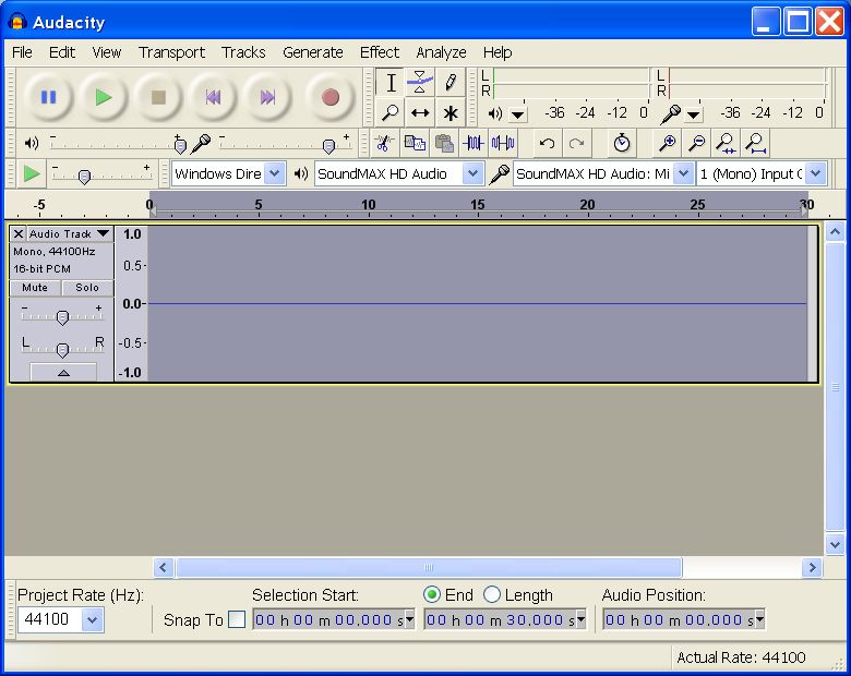

Generated a tone. Plays silence. curiously, i don’t see a sine wve in the graph window?/ Why not…
i have both the lame libs and ffmepeg configured correctly.
uploaded a picture:
using windows direct X choice.

Where did you get those from? The drivers should be the latest ones meant for XP SP3 (64-bit if you have 64-bit XP) supplied by the maker of the computer (or the maker of the motherboard if you built the machine yourself).
Did you try rebooting the machine?
Missed your question on the drivers.
i got them from the dell web site, the machine is T3400
I checked on this about 8 months ago and these were not there so they must have changed something…
Ken
If you reinstall Audacity from the installer at http://audacityteam.org/download/windows , ensuring you enable “Reset Preferences” half way through the installer, then launch Audacity, where is the Audacity temporary directory set to?
Thanks. I am not clear, if you restart Audacity can you now hear playback?
other post didn’t quite make it…
Yes it works now
the problem was the temp path.
Set produced SystemDrive=C:,TEMP=Temp, TMP=Temp…no C:, yet all other programs using the environment variables work fine…
Audacity cleary uses the literal value in the Env or the preferences…as any well behaved linux app should!
thanks for the help
Ken
