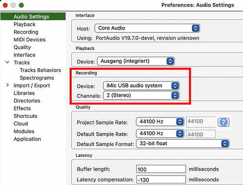

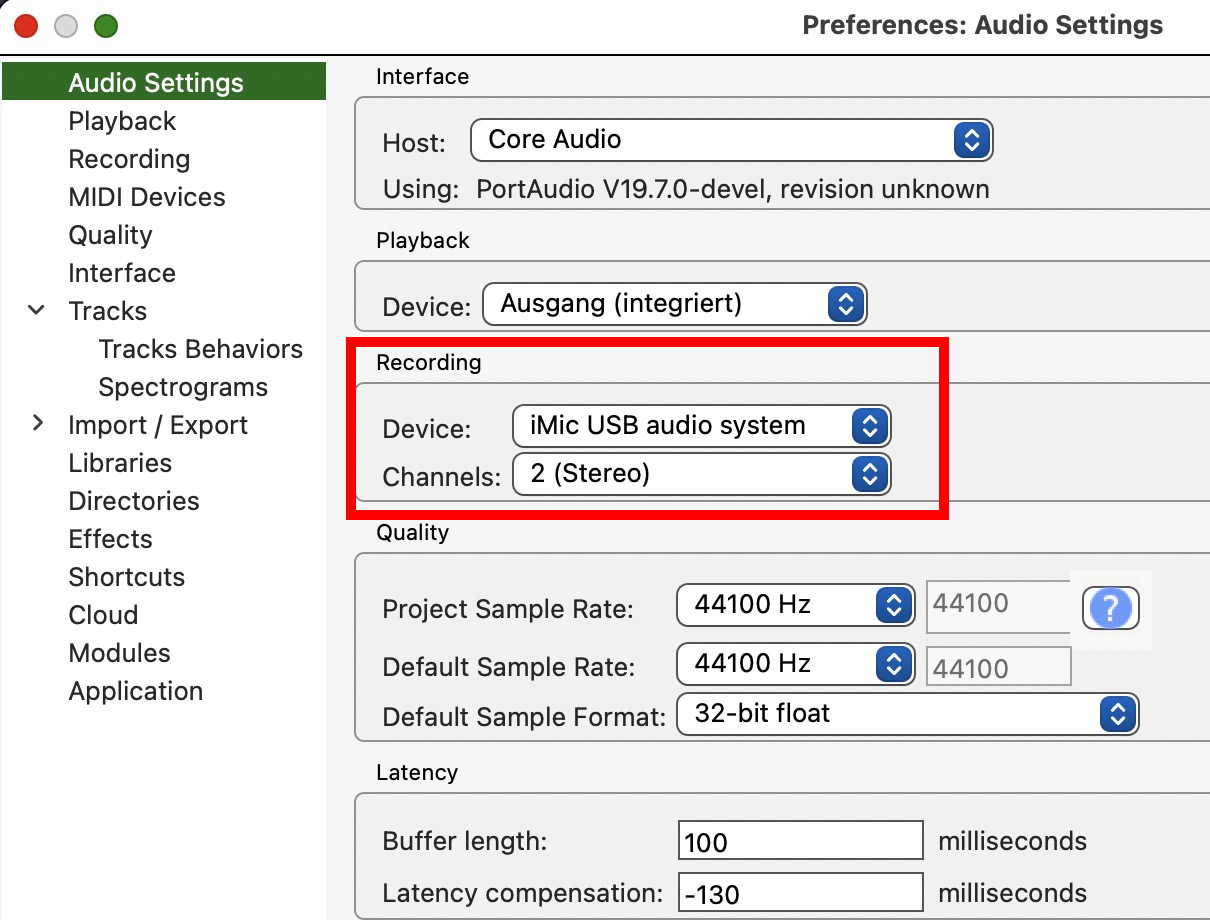

In Audacity’s “Preferences” you should see something like this - the “iMic” is my external sound card:
You can select the sound sourcce there or also using the “Audio Setup” button of Audacity.
