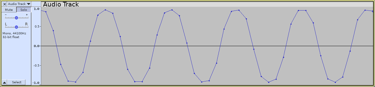

This is a 5000 Hz square wave in a track with a sample rate of 44100 Hz (about 8 times higher than the square wave frequency. Observe that it does not look very “square”, because 44100 Hz sample rate can only support the first harmonic (15000 Hz) and no more. The next harmonic would be 25,000 Hz, but that’s too high for a sample rate of 44100.
