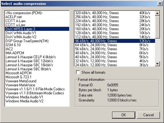

Not necessarily. Most native Windows programs use the Audio Compression Manager (ACM) to read from or write to Wave files.
This means that the audio formats that an application “supports” in Wave files depend only on which ACM Codecs are installed on the computer.
http://www.unger-markus.de/dvd/VirtualDub_Audio_compression.jpg
(BTW: FFmpeg uses its own “built-in” decoders, of course, but it should support pretty much any relevant format from Wave container too)
