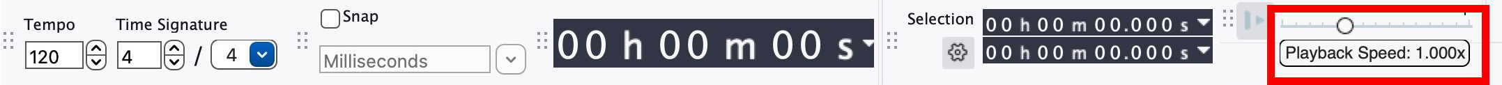

May I throw in another idea?
I think Audacity is recording correctly - but your “Playback speed” might be set to something smaller than “1.000” in the “Play-at-speed” toolbar:
