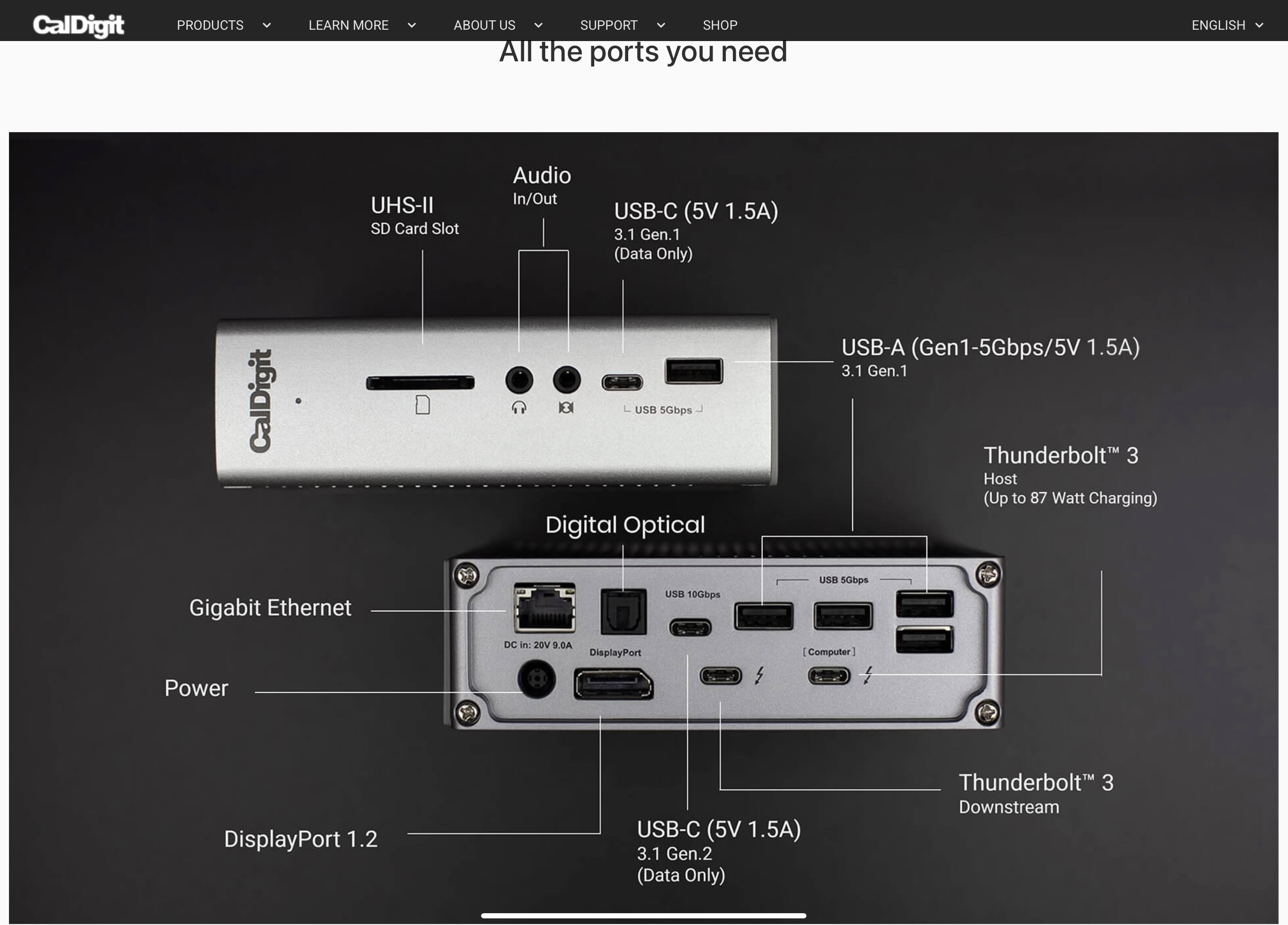

Here is what I was looking at

The mini is thunderbolt 3
You’d have to check if the audio input is a mic or line input, or if it’s configurable.
I don’t see any type / model mentioned for your device - so I can’t say whether this would work for a recording setup. Do you really need so many USB ports (whose functions are not clear to me), Thunderbolt, Display port, Ethernet, etc.?
I’d suggest you get a device labeled as “external sound card” to connect to your new Mac mini via USB. In this forum I often see the “Behringer UCA 202” recommended, which is around 20-25 US$. You’d probably also need an adapter cable from the old USB to USB-C. However, since I do not own such a device, I can’t tell anything about quality.
I myself still use a “Griffin iMic” - but this has been discontinued a long time ago - with an iMac running Sonoma and a MacBook Air running Sequoia.
You have to shop carefully. Most “USB soundcards” like this have only mic-in and headphone-out. Some have a single mic/headphone combo jack.
Well, I’d not call this an “external sound card” - rather, an adapter for old-fashioned, 2-plug headsets (mono microphone and mono or maybe stereo headphones). I have two of them here collecting dust.
Its a CalDigit TS3Plus+
