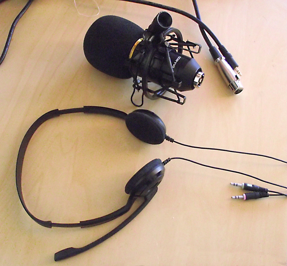

When recording from a microphone, mono sounds awful - muffled and distorted. but stereo sounds fine. Has anyone else found this problem?

Do the microphones have this kind of connection on the bottom?
If so, the cable or interface between that and the computer is causing the problem. That kind of microphone naturally produces two different sounds that don’t mix well and there is no convenient, simple, cheap way to get it into a computer.
I use a Behringer UM2 interface. It’s simple, cheap, works well and it’s certified for musical overdubbing if you’re using it for music.
That’s it on the left.
Thanks for the detailed reply! The first mike is in a headset designed for computers, the second is a studio type mike (both are pictured). BTW, this isn’t a problem now that I know about it: I can easily record in stereo, then convert to mono later. But it was frustrating for the couple of days when I couldn’t work out what was wrong.
That should work as long as you have the correct connection. Sometimes they have separate connectors for the headphones & mic, and sometimes there is a combination 4-conductor TRRS connector. If the connections on the computer & headset don’t match, you need an adapter cable.
Stage/studio mics are not compatible with regular consumer soundcards or the mic input on a laptop, and computer mics are not compatible with mixers, PA systems, or mic preamps, or USB audio interfaces.
Stage/studio mics have a balanced (3-wire) low impedance connection. The two signal wires are out-of-phase, which helps to cancel noise/hum pick-up.* The differential input on the mic preamp amplifies the difference signal and kills the common signal (which is noise-only). The mic input on a computer is not a differential amplifier and it’s not designed for stage/studio mics.
If you use an adapter and split one signal to the left and the other to the right, they will be out-of-phase. If you just kill one channel and make mono, you might get acceptable results. If you combine those two signals together to make mono, everything cancels. If you listen to the out-of-phase stereo you’ll get some “phase weirdness” as some of the sound waves mix and cancel in the air.
Studio condenser mics also require 48V phantom power (supplied by the preamp, mixer, or interface). A computer can only supply 5V for an electret condenser mic. Dynamic mics (like the famous Shure SM57/58) don’t require any power. There are some stage electret condenser mics with an internal battery.
I’m pretty sure you have an electret condenser mic that designed to look and work like a studio mic. (I don’t know if it can work properly from 5V.) A real studio condenser mic usually costs $100 USD or more.

Just to clarify, as you probably guessed, when I said “studio mike” I was speaking from ignorance. I just meant that it had the studio type cable, and was better than the ridiculously cheap mikes used in headsets. As far as I can tell they are extremely good for the price I paid (about £10 and £20), but of course not suitable for professional work.
