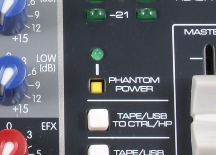

It’s a terrific microphone, but it does take a mixing desk or special microphone amplifier. It’s a grownup microphone with three-pin XLR connections on the bottom for excellent rejection of room electrical hum and buzz problems – but you have to use all three pins to get the benefit. It takes power in the form of “Phantom Power” 48volts. It’s called Phantom Power because the mixing desk sends power to run the microphone up the cable at the same time the music is coming down. It’s a neat trick, but you need a mixing desk or amplifier that knows how to do it.
Just to start somewhere, the Peavey PV6-USB should do everything you need. It will supply your microphone 48 volt phantom power, it will amplify the sound and apply it to the computer USB connection. Audacity will take it from there.
