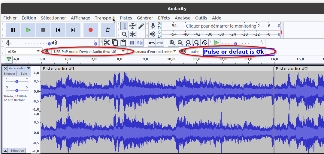

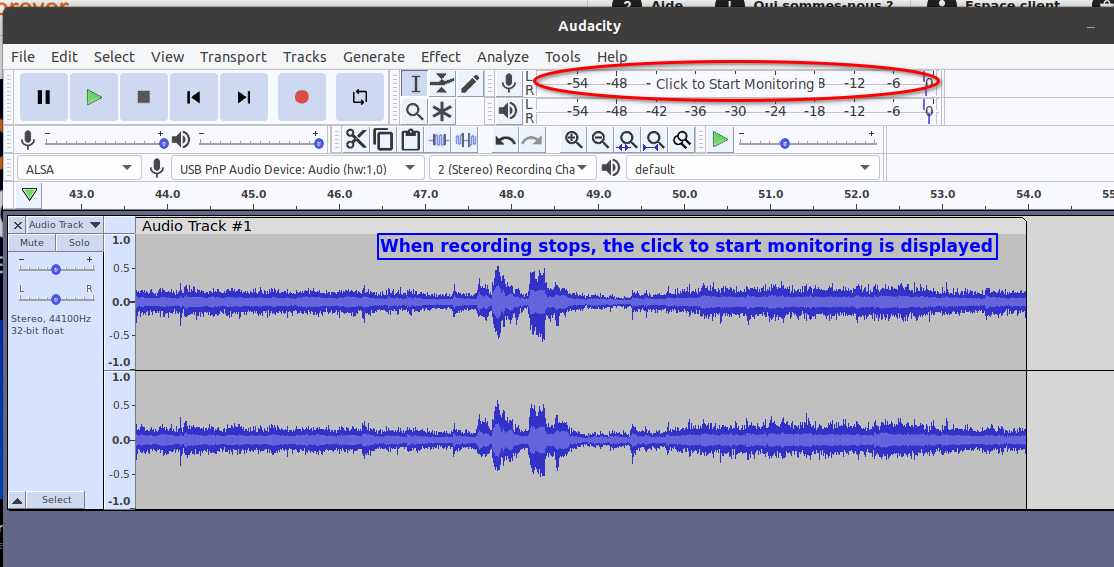

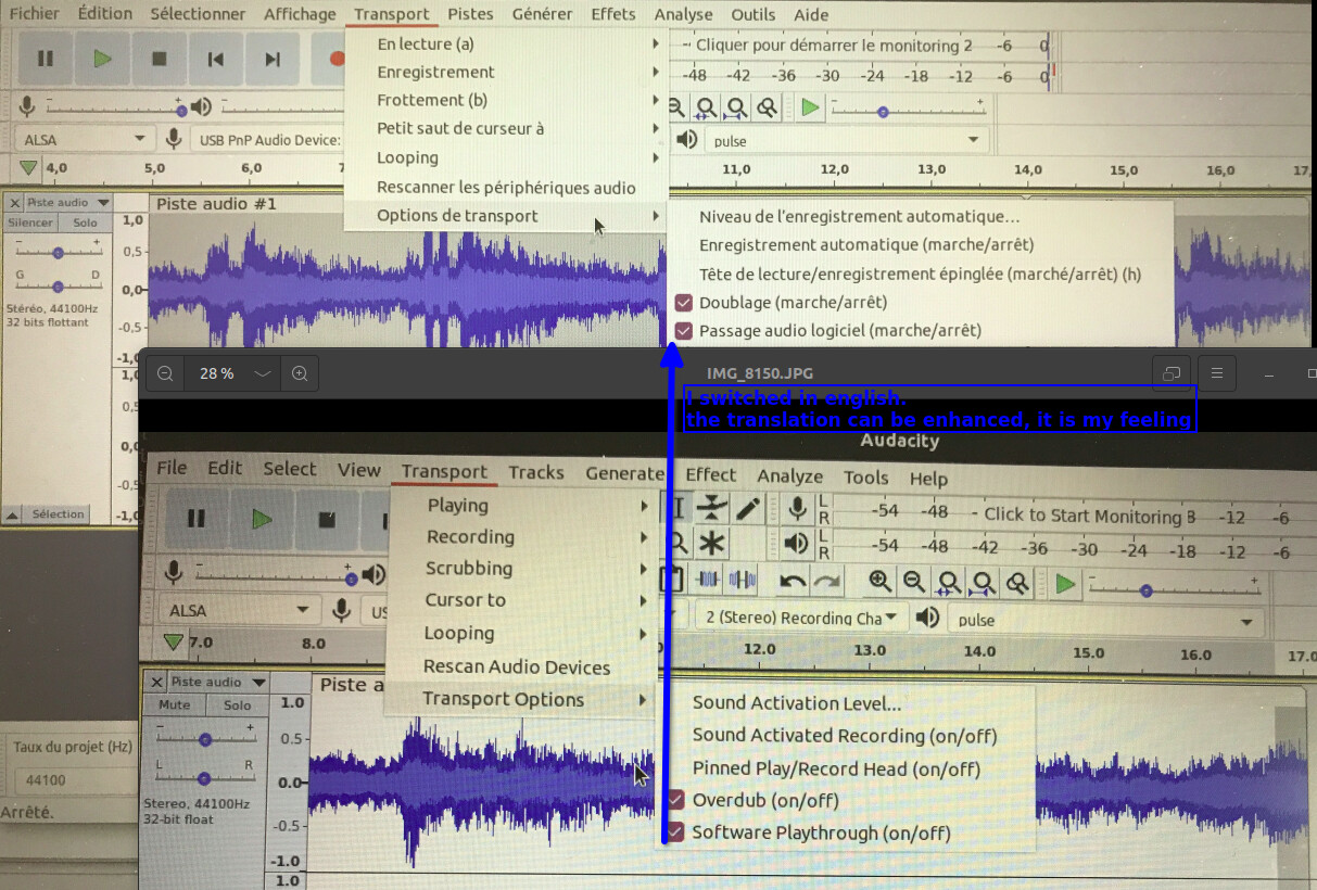

Hi Steve,
Some good news and some not.
I tried to collect and share with you all information.
Good news : what you suggest is working as expected, of course
Not so good news : it works only for a few seconds, then recording stops.I don’t know why. Sometimes one click on “record” and it starts again, sometimes several clicks are needed, but each time after 1,5,10, 15,45, 60 seconds it stops again.
I made a test on a full vinyle so around 20minutes without the “software playtrough option checked” the recording is working as expected, but of course no playback during the recording.
See the screenshots:
