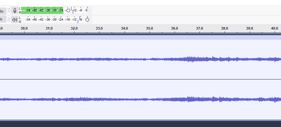

I’m beginning to think it’s a problem with the hardware. Even though the music and volume coming out of the main speakers is quite loud this is all I get on the recording level.
Varying the record meter at the top has no effect on the apparent recording signal as indicated by the trace.
That’s low but it might be OK. Run the Amplify effect (now, after recording) and if it sounds OK, you’re good.
