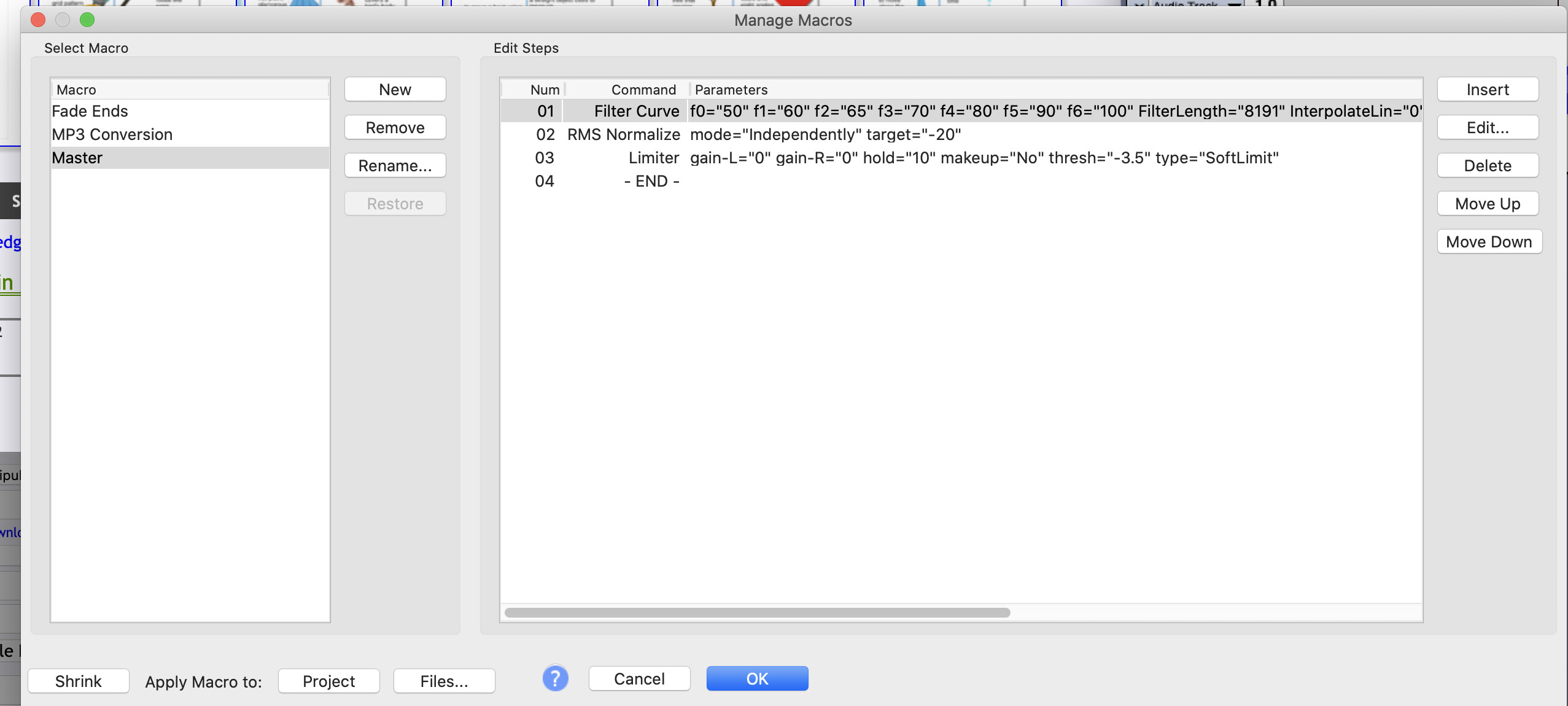

Also, here are the mastering specs I use.

Can you post the actual Macro text? I’ve been avoiding publication because of the wonky way Loudness Normalization behaves.
