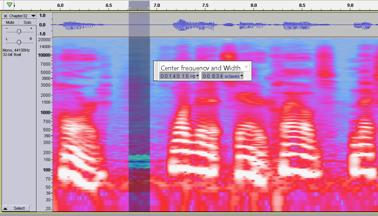

There’s a constantly present fan noise between 40-90Hz, and at ~140Hz (139-142Hz)
Your voice goes as low as 50Hz, so removing the fan without damaging the voice would need AI, e.g. Adobe Enhance
This may be from the computer fan and @billmoffatt may not be able to control that without some expensive isolation solutions.
I have a memory of someone mentioning a notch filter that only kicked in when the decibel level was below a certain threshold. Anyone else remember this? It may be something built in to Audacity that I’ve just never used.

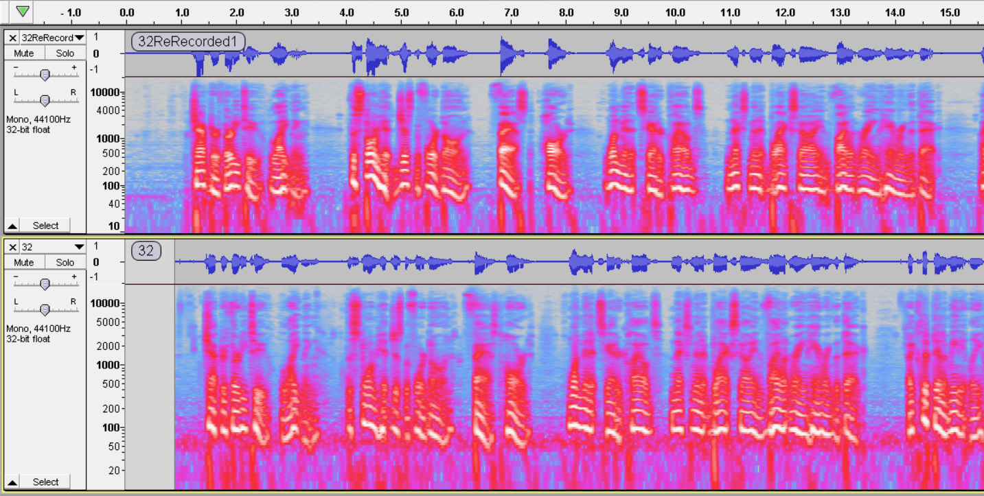

I decided to scrap Audacity and purchased Adobe Audition, Tried recording the chapter with it instead. Does this come across any better? Thanks for your input, it is greatly appreciated.
The (fan?) noise between 40-90Hz is much reduced on the ReRecorded version…
