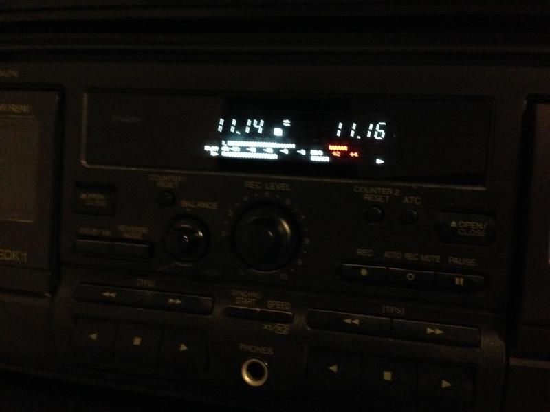

Gaze at the sound meters on the cassette machine while you play the tapes. Forget Audacity for a minute. A normal tape should make the meters bounce in the middle third of the range. Tape machines tend to control sound during the recording but not the playback. So if you have old tapes, what you got is what you got. Pray for good recordings.
If you have any Audacity blue waves on the timeline at all, that’s probably good enough. The blue waves measure about the top third of normal show volume. If you have no blue waves and the Audacity bouncing sound meters bounce in the lower third, then, yes, that may not be useable. The tape hiss will kill you and no, you can’t get rid of it with Noise Removal.

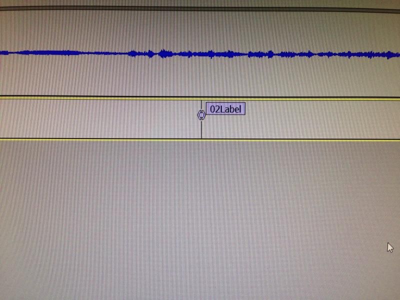

There it is. Analyze > Regular Interval Labels.
After you throw labels around, you can then File > Export Multiple and Audacity will create a pile of sound files each of which starts at a label.

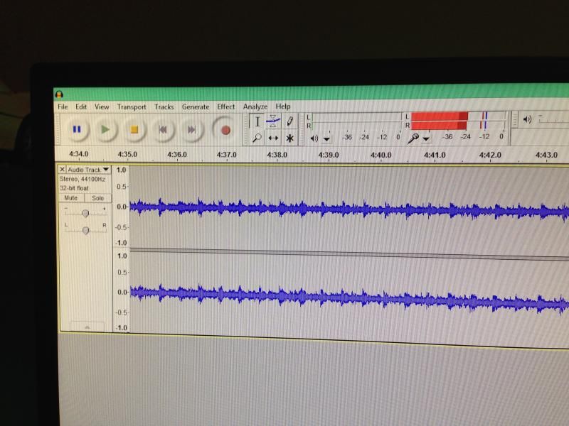

Thanks for your advice! Here’s some pics I just took of the screen during recording (forum wouldn’t let me use IMG codes)
http://i112.photobucket.com/albums/n179/Lozizetec/recording/289D4C81-635F-4D43-B7CA-D2BD6FD47DE2_zps8g5pocv1.jpg
http://i112.photobucket.com/albums/n179/Lozizetec/recording/7AD26F57-E378-4E0B-8C7D-53DA6890A782_zpsdzuhnpdy.jpg
The levels on the player

Tried the label intervals like you said

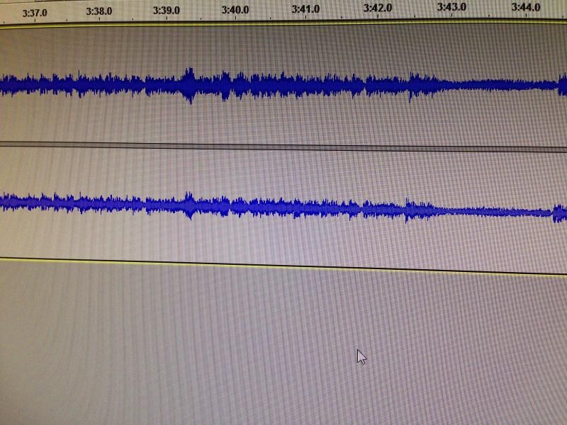

The left and right channels aren’t very even

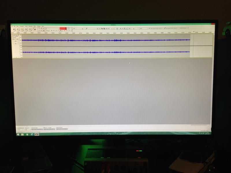

Does that look ok to you? Am I correct to record in stereo and is there anything I need to do to the recording before I export it?
With the labels will it cut the track up I to bits when I export it to MP3?

Try Effect > Normalize to make it a bit louder (a peak of -1 dB or -2 dB is good). To make the channels the same peak amplitude, enable “Normalize stereo channels independently” in the Normalize effect.
Yes if you want stereo.
It will be exported as separate files if you use File > Export Multiple… . But the MP3 format adds silence padding at the start and end of each file, so you won’t get a continuous performance unless your player can play MP3’s gaplessly.
