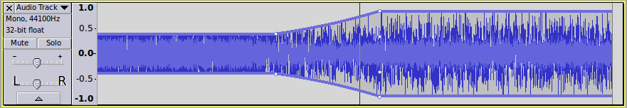

As there is “one” change that you wish to compensate for, I’d suggest that you use the “Envelope Tool” http://manual.audacityteam.org/man/envelope_tool.html

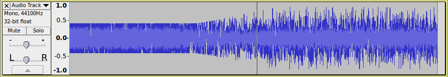

If you imagine that this is your track:
Then you would use the Envelope tool to bring down the level of the first part like this:
Note that this will not fix the distortion and the height of the waveform in the first part will look smaller than the latter part because the peaks are missing.
Then apply “Tracks menu > Mix and Render” to “apply” (fix) the the envelope. (and press F1 to go back to the normal “Selection” tool.)
