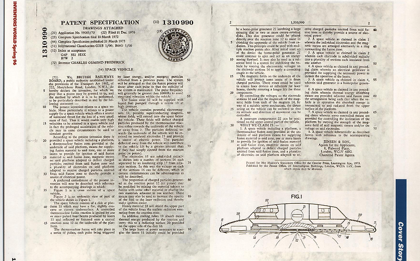

Just because a patent has been granted is not proof that it actually works.
e.g. a patent was granted for a nuclear-powered flying-saucer …
OOH - I want one of those for Christmas :sunglasses:
P.
It was patented by British Rail, so it will arrive late … https://youtu.be/0-ZeCXYr_Uw
