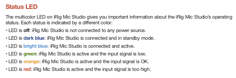

Audacity activates my mic (its light turns on)
I don’t know that the light is supposed to turn on to indicate recording. It’s supposed to be on to indicate connection to the computer. If it turns on just before recording, you may be listening to the microphone startup/powerup which can be really noisy.
Click in the recording meters > Start Monitoring. That will turn the microphone on and measure it to make sure it’s OK before you actually record. The recording meter should bounce with your voice. Then press the Red Record button from there.
