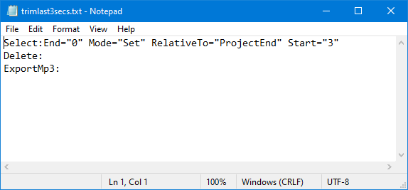

@chefralsei
try this little macro:
For clarity I set up that first step like this:
Hope that helps,
Peter
