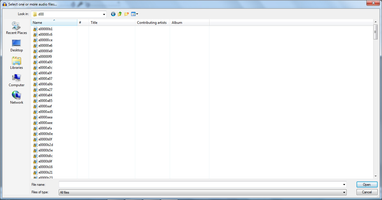

I do still have about 6 folders, each with several dozen very small raw files…
is there a way to bulk import them so that they return to order? They’re not even in sequence in the folder, so if I try to do it one-by-one it could take hours and hours…

Unless the project is an unedited recording, the AU files cannot be made into the original project except by dragging each one into the project and rearranging the clips by hand. If you drag a few of the AU files into Audacity, do they still contain your audio, or are they now silence?
If they are not silence then it may be possible to revert your renamings. As part of that, you may need to open the AUP file and change the “projname” to the original name of the _data folder. If you need help, please attach the AUP file. Please see here for how to attach files: https://forum.audacityteam.org/t/how-to-attach-files-to-forum-posts/24026/1

I’m also attaching a screen shot of one of the subfolders, which I’m sure you’re familiar with.
It sounds like from what you’ve said that my only option to restore the original project is to load each of these hundreds of sub-clips into a new Audacity project…is there any way that they can be sorted by time stamp order, or do I need to use trial and error or try to go by the ordering of the letters and number combos? if it’s the latter I’ll probably abandon the restoration and just ask the guest if we can re-record, as it wouldn’t be worth the potentially couple full days of work to do a restore this way.

This original show was called shara part 1. The name is burned into the AUP file. Does that ring a bell? You can put the AUP and _DATA folders back to that name and the show should open.
Yes but unless this is an unedited recording, the time stamps don’t relate to the position of the AU files in the Audacity waveform.
So you should try what Koz said. Get the name of the AUP file, “projname” in the AUP file and the name of the _data folder the same.
To rename a project safely in future, open it in Audacity, File > Save Project As…, close the renamed project then delete the original AUP file and _data folder.
Yes, Koz- simply renaming the project and data folder worked! Thank You!
