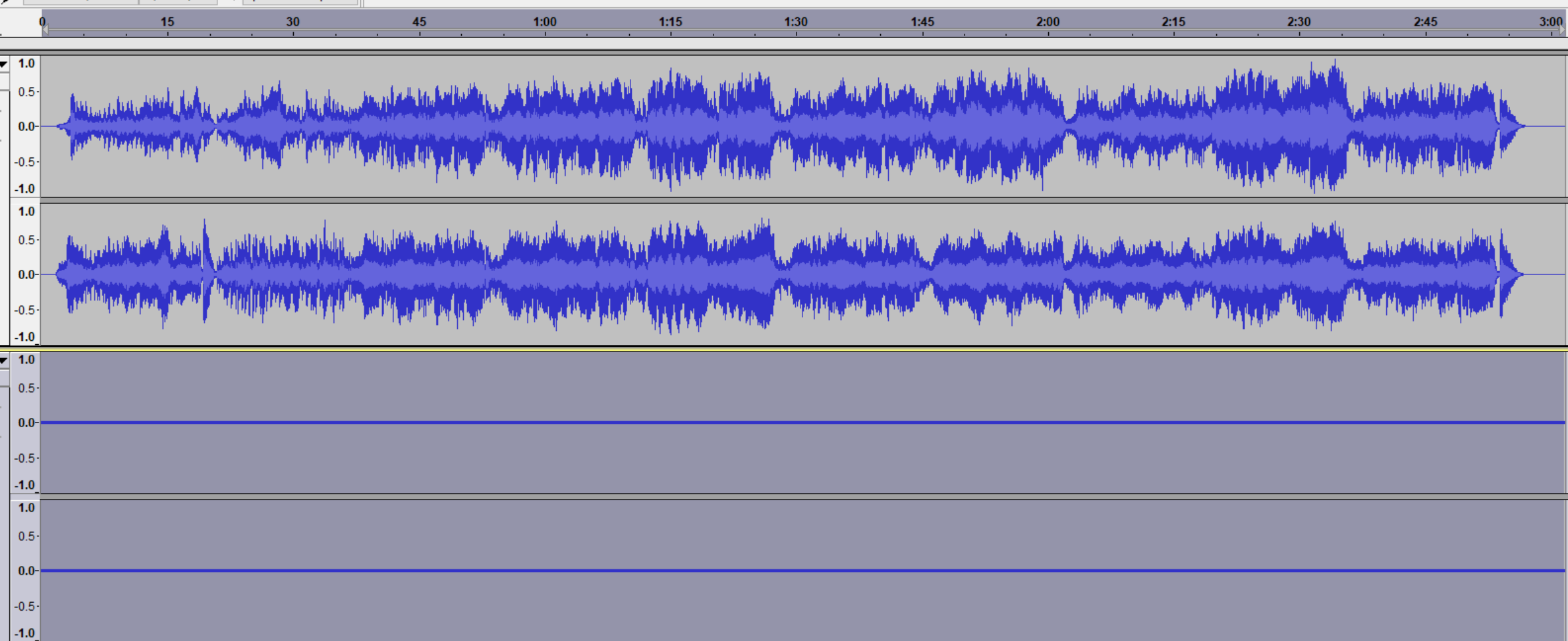

- Import your music track
- Tracks>Add New … (stereo or mono as appropriate)

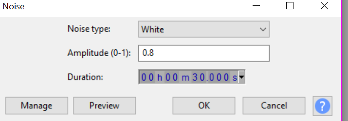

- Generate Noise
- Mix&Render (permanent change) - or just Export (temporarily mixed for export)
After step 2 the new track should be “focused” - not the yellow border
and it step 3 the noise generated should be the length of the audio imported in step 1 (it did when I tested on 2.2.0 just now).
WC
More or less clear. In my opinion, enough steps 1-3. True, noise is only 30 seconds, but usually more is not necessary, on the contrary, it takes 10-15 seconds, thank you!

Dear waxcylinder, you have said it a little bit. It turns out that we must select the whole track before adding noise (steps 2-4). Then the length of the noise will be equal to the length of the track.
Oops yes, sorry that was sloppy of me ![]()
WC
