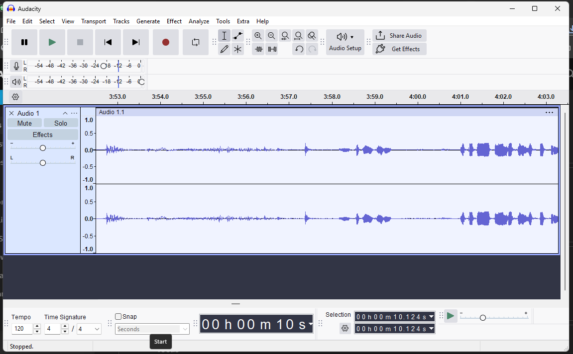

Thank you Doug. How do I turn them up please?
This is the screen at the moment.
What do I click on? Nothing happens when I click on the green bit next to the mic icon, top right.
Thanks
Click that little bubble that I see between -6 and -12dB and drag it all the way to the right. That should solve it as long as the audio stream is coming-in at 100%.
Your playback volume is already at 100% but you might need to check your Windows volume too.
