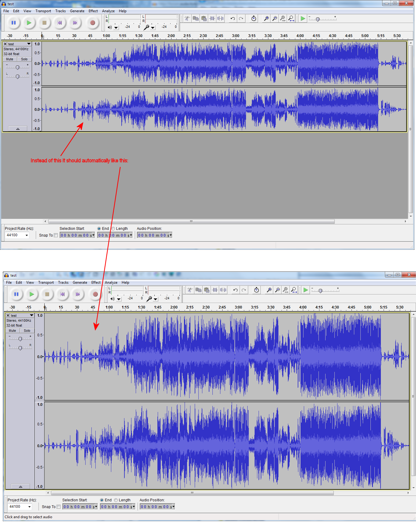

Assume I drag & drop an *.mp3 (stereo) file onto Audacity 2.0
Then the two audio channels appear in the main sub-window of Audacity BUT they do NOT use the full/maximum possible sub window dimensions.
Instead they are drawn in a kind of sub window of the sub window.
How can I tell Audacity to atumatically maximize the audio channel display?

I don’t think I can follow that. Can you post a screen shot?
Ok, have a look at the attache snapshot
Edit…Preferences…Tracks…Automatically fit tracks vertically zoomed - tick this box.

BUT: There is still a horizontal and vertical slider visible.
How can I maximze the track window so that NO horizontal and vertical scrollbars are shown ( at least as long I perform no zoom operation)?
If I am understanding you correctly, you can’t! The vertical scroll bar and the horizontal scroll bar are always shown.
When doing a Fit Vertically, sometimes a vertical scrollbar is shown and sometimes not - it seems to depend on the size of the window and the number of tracks. You can experiment with this by importing a few tracks, doing Fit Vertically, resizing the window a bit, Fit Vertically, etc. There is a minimum track size, and if the window is too small vertically to show all tracks at their minimum height then you will get a vertical scroll bar and not all the tracks will be visible.
