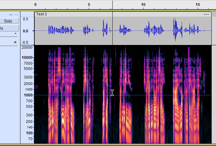

Hello all. I would appreciate any advice you have on improving this audio clip.
I’m using a usb condenser mic with pop filter and running it though audacity.
I’ve used noise reduction to remove background feedback but I’m also getting feedback on my voice.
Do you know why this is happening or how to edit it out please?
Thankyou for your input

https://support.microsoft.com/en-gb/topic/disable-audio-enhancements
Notch 1000Hz … Spectral Selection and Editing - Audacity Manual
Thankyou Trebor. Some great suggestions to try
The 1000Hz artifact is a USB thing … Understanding USB Microphone Whine – 0xStubs
It can be notched out …
1000Hznotch
But prevention is better than cure: the notch causes collateral damage.
