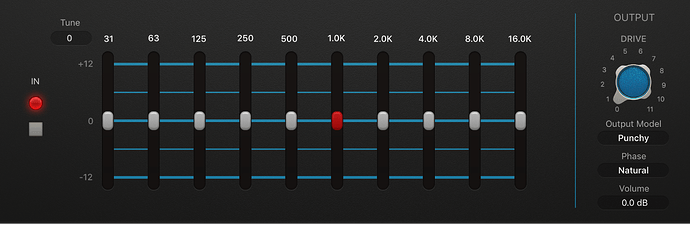

Looks like about 25%
(Does anyone look at numbers when using a hardware Graphic?)
If you need a numeric answer, hover your mouse pointer over the slider.
Apparently, this one is from Apple’s flagship DAW “Logic Pro”:
