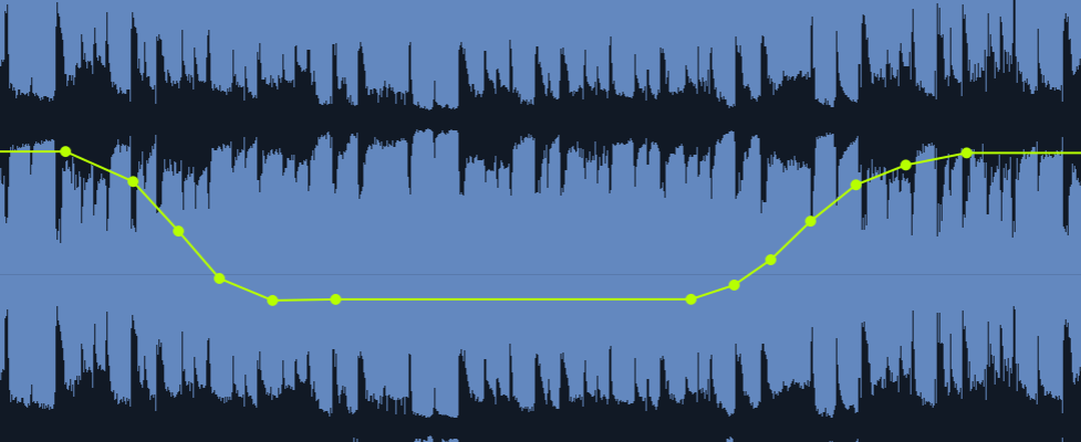

I would like to suggest adding Bézier manipulators (handles) to the clip gain points.
By default, clip gain points should follow a smooth curve, and it would be great if we could right‑click on a point to set its value manually in dB.
Additionally, I suggest renaming the “Clip Gain” tool to “Volume” and adding a PAN tool, so that we can create smooth PAN automation points with Bézier curves in the same way as with the Volume tool.
