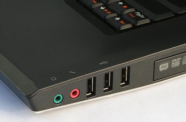

Does your laptop have three different connections for sound? If not, then your laptop may be normal and only have one mono microphone connection.
Some laptops present that one connection as if it were two, but that just results in two-track mono—what you have.
