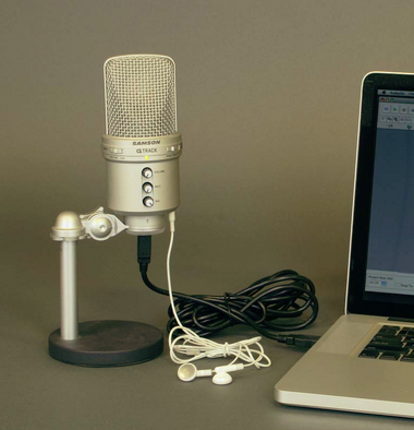

Yes, or a microphone that can give you local wired headphone connections.

Thank you, given this, I think my most effective method is to upgrade my mic to one with real time headphone monitoring. As long as I can hear both the track and vocals I should be solid.
