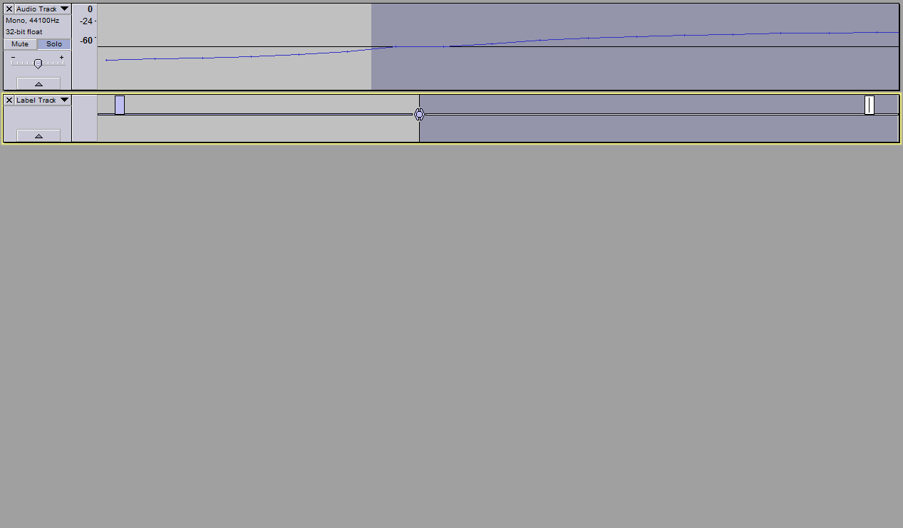

Discrepancy in zoomed display of the region and of cuts
Attached, see an audio track and a label track. I generated the labels with a Nyquist plug-in and was careful to define label boundaries midway between samples. The result of picking the right label is shown. Picking the left label highlights the complementary areas. The selected part of the timeline above the track display agrees with the label track. The boundary highlighted in the audio track appears one sample too far to the left.
If I then hit ctrl-i, the new cut appears to go THROUGH the extra highlighted sample of the audio track, not between samples. I am not sure which side the sample actually goes to. I hope it is the left side.

Well the question is, which region of time is really selected? And where is the cut boundary after ctrl-i, really? Because I don’t know which of two disagreeing displays to believe. This mismatch can’t be correct behavior!
The label selection is a selection of “time”. The audio track selection is a selection of “samples”.
The way that digital audio works is to “quantize” time into sample periods. You can’t have “half a sample”, so durations of sound are always quantized to a whole sample period.
The quantizing is NOT rounding to the nearest, because that produces (sometimes unexpected) “off by one” errors, but rather quantizing uses a “cut-off point” that is the mid point between samples.
  • If a sample is before the “cut-off point” at the start of a time selection, it is not included in the selection.
  • If a sample is exactly on, or after the “cut-off point” at the start of a time selection, it is within the selection.
  • If a sample is before the “cut-off point” at the end of a time selection, it is within the selection.
  • If a sample is exactly on, or after the “cut-off point” at the start of a time selection, it is not included in the selection.
So, odd as it may look on occasions, both are correct, but they are showing different things. The Label track (and the Timeline) show (not quantized) time, whereas the audio track shows sample periods (quantized).

Please explain with reference to the picture above. My label boundary looks to be midway between samples. How is a label boundary time quantized into a cutoff point, truncation or rounding? How is it that the “cutoff point,” not directly shown, looks yet another sample time left of the boundary? How should I change my own arithmetic in calculating my label endpoint, so that the right label covers one sample fewer and the left one more? Should I put it at a calculated sample time and NOT worry about roundoff in that calculation?
It seems I tried to label at midpoints between samples to avoid off by one errors… and in my misunderstanding of things, that only created such errors. Some of the boundaries I get do not look like this.
I wrote my Nyquist to put my label boundaries midway between sample times. Was that a bad idea? It looks like roundoff error put my label boundary slightly left of a cutoff point, therefore truncation of that time to a cutoff includes one more sample. Is that right?
Then the zero-crossing finder I’ve worked on needs another revision.

I did and I get these pictures and they confuse me. It SEEMS that clips are drawn so that their edges pass directly through samples. Therefore a gap of one sampling interval appears between them. But this gap is either highlighted or not, depending on which of the clips is selected. THAT behavior, I find confusing, and I don’t know whether to call that a display bug. Is the leftmost sample of the rightmost clip a part of the second selection or not?
In Nyquist, assuming that you are using floats and not integers, label positions are calculated to 32 bit float accuracy (single precision).
In Audacity label positions are calculated to at least double precision (possibly greater).
The “cut-off” point (inter-sample division) is mid way between the time values of each sample. Sample positions are calculated to either double precision or a native 64 bit integer format (depending on context, but either way it is better than 32 bit float accuracy).
Yes they appear to be “on” the cut-off boundary, but there is no way that I can see the difference between 0.999999999999 and 1.000000000000 or 1.000000000001.
To guarantee sample accurate positioning of labels, you need to ensure that the label positions are within the sample period. If you use the (exact to 32 bit float) sample position, then that will be within a sample period.

Note that in the above example, the Selection Toolbar will show the Selection Start as “9 samples” (because there are 9 samples before the start of the selection) and the end of the selection as “20 samples” (because there are 20 samples up to the end of the selection) and the selection length as “11 samples” (because there are 11 samples within the selection).
If a “cutoff point” is defined as the midpoint between samples, then how can a sample ever be “exactly on” a cutoff point?
If “cutoff point” means the rounding of a label boundary to the nearest sample time, I can make sense of this list, but you have told me that is not what it means.
Count me still confused.
As for the display and how to interpret it: these pictures make it seem that midpoints between samples define the boundaries of colored regions of audio tracks, when there is no cut boundary. But when there is a cut boundary, the colored region extends to a sample, not a midpoint. Why that difference? How should I interpret what I see with a cut?
Change the term “cut-off point” for “time boundary” - does that make sense now?

Yes I was suggesting to snap selections to sample periods even if Snap To is off.
But visually it’s unconvincing to say that we snap selection to sample periods if Snap To samples is on. It looks like we snap to samples. If Snap To samples is off, you can drag the selection as finely as you can move it. If Snap To samples is on, you can only drag the selection so that it aligns with a sample point.This produces the ugly “gatelegged” appearance and the confusion Paul has described.
As another confusion, whether Snap To is on or off, you don’t get the pointing hand when hovering over the selection edge in the waveform - the selection edge has effectively moved into the Timeline.
It’s just as well the Manual doesn’t try to document this.

I see that the selection in the 9000 Hz track is snapping between sample dots (fair enough on Audacity 's own terms) and because the audio track above is at a higher rate and also obeys snapping between sample dots, that selection is smaller.
In that image, I don’t see why having to choose which sample rate the selection snaps to would prevent the selection in the label track also snapping in-between sample dots (if that is the choice we make).

Possible behaviour if dots marked the middle of the sample period:
  • Dots mark the middle of the sample period.
  • Selection in audio track snaps to the middle of the sample period.
  • Selection in the Timeline/Label tracks snap to the dots.
The only thing that we have really changed is “what the dots signify”. They now signify “sample periods” rather than “the time of a sample”.
The selection in the audio track will now snap to the same position as the dots.
The selection in the Timeline still snaps to the same position as the dots.
When the audio track has the same sample rate as the Project Rate, there is no dogleg - the selection in the Timeline is in line with the selection in the audio track.
I’m not convinced that this would be better than what we have now, but it would “look” neater, provided that the audio track sample rate is the same as the Project Rate (which it usually is).
OK so you now think that by moving the sample dots to the middle of the sample period, you could do what I asked for (have selections in the Timeline/Label tracks snap to the sample period crossover points, avoiding the dogleg) and without risking off-by-ones?
And do I assume by the same logic that mouse clicks in the audio track would “snap to the dots” as now, so would now snap in-between sample periods rather than at sample times?
if so, then we would have a scheme that is more consistent, intuitive and hence more documentable. So I would see it as a potential advance. It is not the Wavosaur model which I think is the easiest to grasp (providing you could visually demonstrate when a sample was in the Timeline selection and when not).
Subject to my questions above, it seems to be a considerable improvement. Clicks and both types of selections would snap to the middle of the sample period, and that position is where the sample dots are.
The big drawback is moving the sample dots away from the sample times, which is about the only thing that is easily grasped with the current scheme :sunglasses: . There would probably be a mistaken assumption that we were snapping to sample times.
It could possibly be ameliorated by using a different representation than a dot e.g. ][ (essentially an I-Beam with some kind of impression that it was two boundaries attached to each other). If you imagine those in a waveform
it’s not totally unconvincing (to me). But before voting for that (as opposed to “mouse clicks and timeline/audio selections snap to sample times, dots at sample times” which needs a complete makeover) I’d want to be sure there was no risk.
