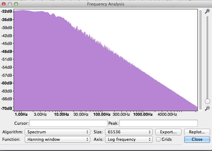

Put low level pink noise into both speakers and Analyze > Plot Spectrum. I know you don’t have an echo-free chamber or a perfect microphone, but I bet the two plots will be wildly different, the Warfdale being the more level and even of the two.
This is what a straight analysis of pink noise looks like (click the pix).
White Noise is level and flat, but white noise is a good way to cook your tweeter.
