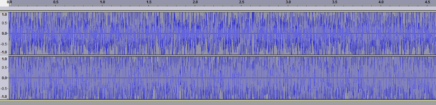

I am using audacity 2.1.3 and am finding the issue around DC offset to be a bit confusing. I have read the manual thoroughly and can’t tell whether or not I should be concerned or not, with my system. I am running Windows 10. When I record LPs or Tapes into Audacity, the result sounds fantastic. Yet, different online postings have suggested ALWAYS use DC offset correction, and others suggest only using DC offset correction if you have a problem with it appearing. The sample shown in the audacity tutorial at:
http://manual.audacityteam.org/man/dc_offset.html

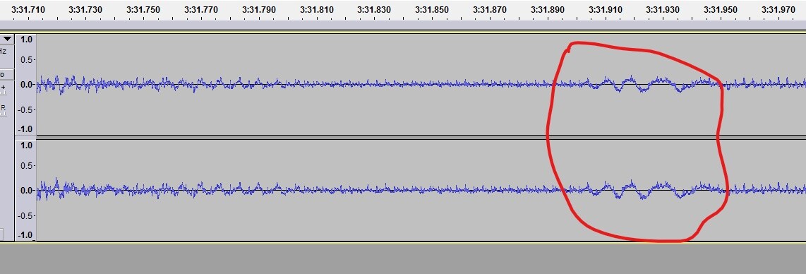

…does not appear to be happening with my recordings, nor do I have significant sections of the recording where this is happening. Only occasionally, here and there, do I have very small micro-sections (I have to zoom in quite deep to see anything) that appear to have some offset.
