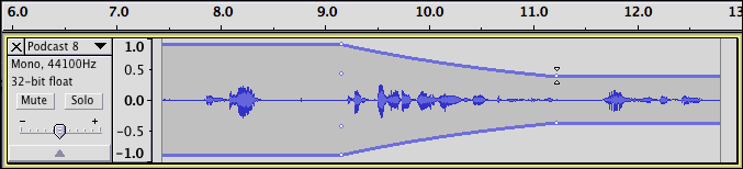

how the extensive is the envelope tool in audacity?
i would like to add a code /function to envelope the sound wave without highlighting or user intervention
analyzing from initial time to last time
refer to the picture above, at 9sec is the initial time to calculate and the ending time is 11… is it possible?
I’m not sure exactly what you are asking, but you could edit the Audacity Project file (.aup) manually in a text editor to create or modify envelopes.
The AUP file is written in XML.
Here is a bit of code from a project file that shows an envelope with two control points, one at time = 9 seconds (value 1.0) and another at time = 11 seconds (value = 0.5).
<envelope numpoints="2">
				<controlpoint t="9.000000000000" val="1.000000000000"/>
				<controlpoint t="11.000000000000" val="0.500000000000"/>
			</envelope>
i want to envelope the wave… and calculate using the previous code with the help of pwl…
or i say… everytime i click the plug-in the audacity automatically highlight the wave track as show in the figure i have to set my time where do i start and where do i end then calculate breakpoints…

There is a specific version of pwl for creating envelopes. This function is “env”.
You can read about it here: http://www.audacity-forum.de/download/edgar/nyquist/nyquist-doc/nyquist.htm (scroll down to the section “Envelopes”).
