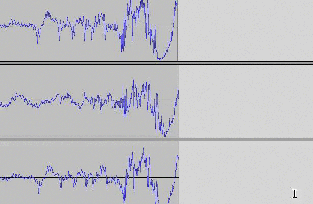

https://i.gyazo.com/6fe6ab70bfa44d1790719e68a39fd290.gif

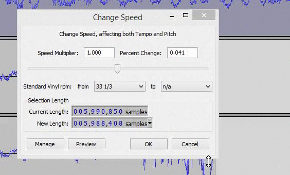

https://i.gyazo.com/a8b8145377f6ac303ba91d93faf72121.gif
I want the exact samples to be 005,988,408 like the other one, but it comes out as 005,988,395 no matter what I do. Resizing the OTHER track too doesn’t work trying to get it from 408 to 395. Any help? It locks me into preset ones.

It is a bug in this version of Audacity. Unfortunately it is unlikely to be fixed in 2.1.2 because we are so close to the scheduled release date, but it should be fixed in the following version.
The problem is that the speed change is being rounded to 3 decimal places, and because your required change is so small, it is being rounded to zero.
