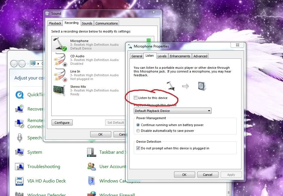

If you must use Audacity, you can unmute the mic on the Playback tab of Windows “Sound” (this is the best solution but few computers can do it) - double-click the speakers or headset you are using, then click the “Levels” tab.
Or you can send what the mic records to your audio output using Windows “Listen to this device” (this will have latency):
Now the audio output also contains the input, you can record it with Stereo Mix or Windows WASAPI loopback. See http://manual.audacityteam.org/o/man/tutorial_recording_computer_playback_on_windows.html.
