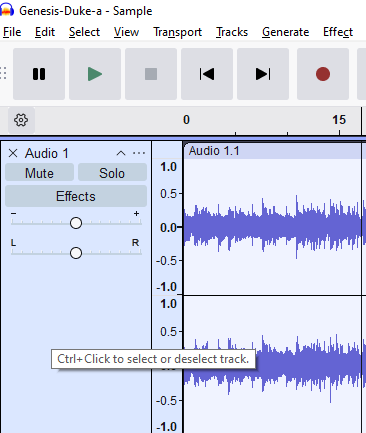

New user, trying to get up to speed. Using W11 and Audacity 3.7.7. Bought an AudioTechnica turntable to digitize my old vinyl collection.
DIgitized the first couple vinyl albums. Playback from the AUP3 files sounds okay on the little speakers on my laptop, but when I export to MP3 or MP4 and play back on my good Bose soundbar, it sounds really REALLY bad. More static than music, as if I’m pushing the speakers way too hard.
Diagnosis? Suggestions?

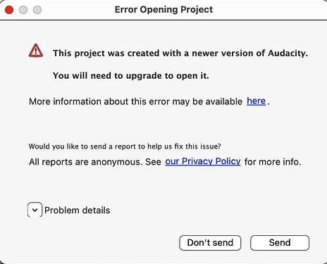

Oh, and while I am typing, you uploaded the aup3. Apparently, you use a newer version than I do (3.6.4), so I am out here…

It certainly is. I downloaded the project file and there was no red at all. However, on playback it was in the red the whole time. Then I spotted this:
The volume was +36dB and it was panned 10% to the left. Once I centred everything, like this:
the audio played beautifully in Audacity and my exported MP3 was great too.

Friends, thank you. I had the volume up like that because that was the only way to get playback from the AUP audible on my laptop speakers. Reset it to +0, and the export is good. So now it’s obvious that that volume setting also controls the exports. So with your help, Problem Solved and Lesson Learned!
