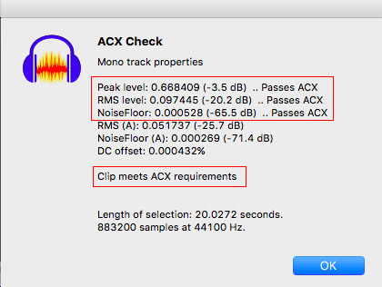

ACX Check is super handy because it has all the audiobook measuring tools in one go as well as a pass/fail announcement. No more Effect > Contrast.
Once you use the tools the first time, the settings stick and whipping through all the steps can be done in about twenty seconds.
