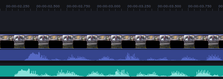

After I finish editing my audio and I export it the audio is also one decimal second out of alignment. Is this something I can prevent from happening?

Well, I gave a screenshot in the first image showing that the original and exported versions are out of synch with one another. It happens no matter how long the audio I’m exporting is. Also, it happens when I export in stereo or mono. I’m using Audacity 3.6.4 and I’ve been exporting at the sample rate of 48000 Hz.

Could you please let me know of which application was used to get the screenshot that you posted? It might be connected with the issue you’ve described.
I use MovAvi Video Editor… but both of you keep mentioning that the length of the file is the same. That isn’t what I was asking about. The length of my exports are the same as the originals, the timing changes on the exports, as per the screenshot I gave in the first post.
If I took a one minute video file and exported just it’s audio, both files would still be one minute long… but the exported audio would start a decimal second before the video’s original audio would. That is the problem I am getting on all my exports.
