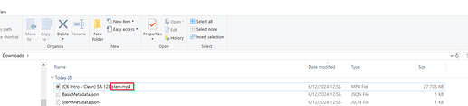

Resulting is a STEMS file, that has all 4 STEMS (DRUMS / BASS / VOCALS / INSTRUMENTS) combined in 1 file.
To be used on other audio gear !
