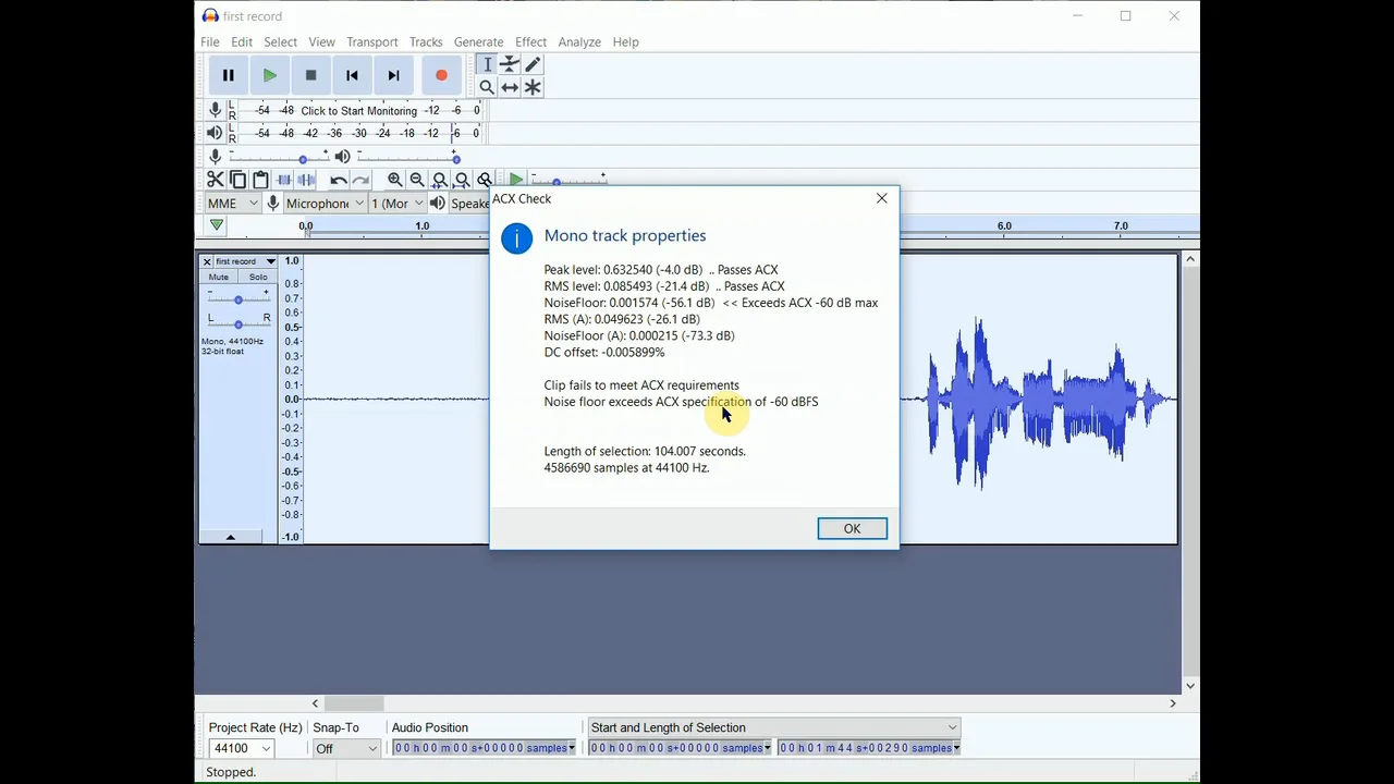

All the answers are in the video, which will require cranking through for anybody interested. Can’t sum up this stuff in a few sentences.
[![](https://forum.audacityteam.org/uploads/default/original/3X/3/c/3ca8c36c20e6e7e176730730c98040269f8b5eb0.webp "Making an Audiobook with Audacity") ](https://vimeo.com/287374350)
My remarks on Chris’s Compressor are after 18:40 in the video.
I use a Shure PG42 USB mic plugged into an i7 computer, in a home office padded with a few cargo mats. Ambient room tone is about -50 decibles.
I would say the learning curve for beginners is steepest when merely listening. Only experience alerts you to the distant sound of an airplane, a truck going by, distance from the mic, or the inevitable accidental change in Audacity settings. If the waveform while recording looks “different,” stop immediately.
Also, be aware of Audacity “history” (in tabs, View/History). Effects applied cannot be removed after the sessions is close–or “saved.” Beware!
The solution (given me by Koz, I recall) is to save recording files in stages, when experimenting with plugins. Before you try a new effect, save any file that is OK so far–because once you close the file it is set in stone and can;t be removed.
