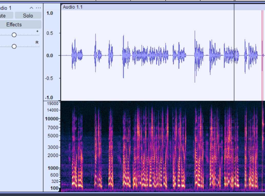

That’s not what I see when I do the spectrum on my end directly from audacity. Is there a weird setting in Audacity for the wav file output? Sample rate 44100, 32 bit float.
turned off Dolby on the laptop and this is what I get:
So that solves the upper frequency clipping.
It doesn’t solve the breath amplification after the 36Audiobook mastering.
I’m assuming applying a debreather in advance may fix that…maybe?
and not having to do them one by one would be nice.

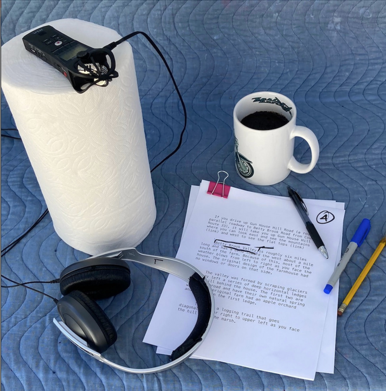

I had a picture of a stand-alone recorder here, somewhere…
This is a Zoom H1n stand-alone sound recorder fully outfitted for voice. Those are Sennheiser headphones with thick, heavy ear padding.
That’s one of my traditional furniture moving pads back there for echo and noise suppression.
I would kill to be able to say I got the paper towel roll at Piggly-Wiggly, but alas, I think I found them at Vons.

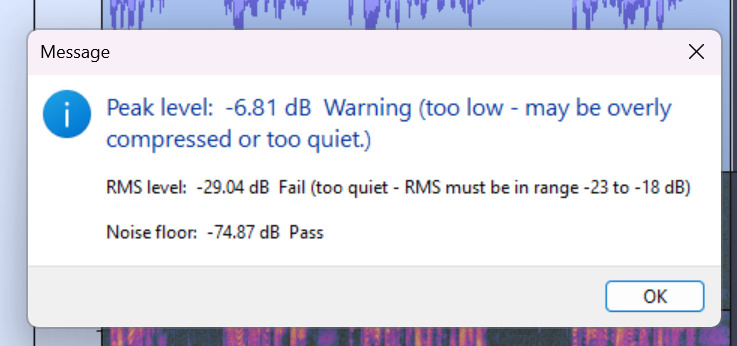

I think I see some of the problem. When I look at the overall volume in the raw clip, it’s not quite what it needs to be–both peak and rms–which means that the macro is going to amplify everything. That’s probably because I’m recording so early in the morning. I’m not using the full voice I would use in the middle of the day.
The unadjusted breathing isn’t that bad–not too different from what you’re showing in the last clip. The worst ones peak around -45 dB, which is about 10 dB softer than the breath you showed, but when it increases the volume on everything, the breathing goes with it and it becomes noticeable.
The fan I see in the multiplot shows up in that lower than 100 hz band so the 36audiobook macro is likely to cover it over, as long as the base volume on the recording itself is high enough in the first place.

Doing a quick check on the 36Audiobook macro within a clean section yields a pass on all counts (which I immediately undo, since I’ll be applying that macro at the end to the whole).
