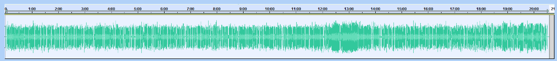

NO:
YES:
This one is consistent all the way through, and has been normalized (increased) to -2db volume. :slight_smile:

Those images are NOT TO SAY you should RECORD with the gain that high. The lower gain in the first one is FINE, so long as it’s loud enough that you’re not losing audio. In fact, having the gain set as low as possible without sacrificing quality is GOOD.
But the FINISHED PRODUCT needs to be brought up to -3/-2db and it needs to be CONSISTENT in volume (hence the compression plugin.
