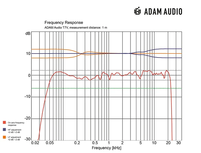

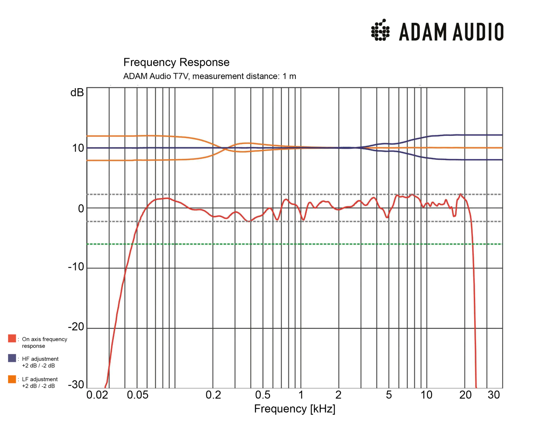

It of course also is true for speakers. Even something like the Adam T7V, which uses a ribbon as a tweeter (much more lightweight and thus easier to jiggle than a dynamic tweeter!), only gets up to 25 kHz. – something they explicitly boast about!
