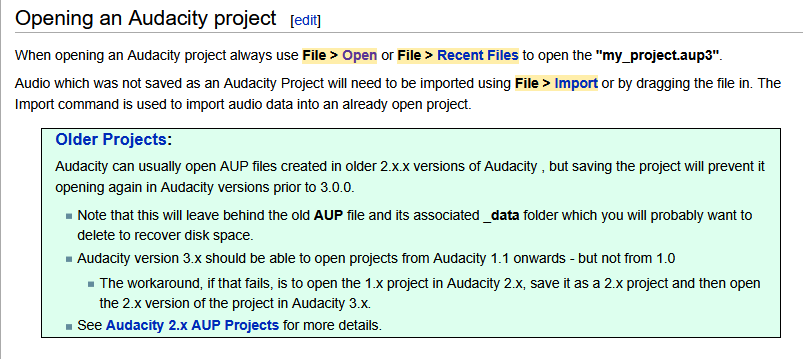

I’m puzzled that you write this as following these instructions in the manual *which I wrote some years ago after extensive testing_:
So I just did some re-testing and I found that 3.7.4 will successfully open AUP files created with
a) any version of 2.x.x
b) and surprisingly any version from the Beta series 1.3.x (so the manual is actually more conservative in its statement - I may change that for the next beta manual)
This also works if the project references external aliased audio files (provided those files exist and are in the location that the project expects).
It won’t open a project made in 1.2.6 as indeed the manual suggests - but following the manual’s instructions I:
  1. opened my 1.2.6 project in 2.4.2
  2. saved it as a differently named AUP project
  3. launched 3.7.4
  4. successfully opened the project created at step 2

Peter,
Then puzzle no more.
  1. I wasn’t aware of that bit of the manual. (RTFM then, Mr B)
  2. The project file that I was looking at must have been 1.2.x because it sure as hell wouldn’t open in my version of 3.7.4. Well, it would open but there was nowt in it bar the label track.

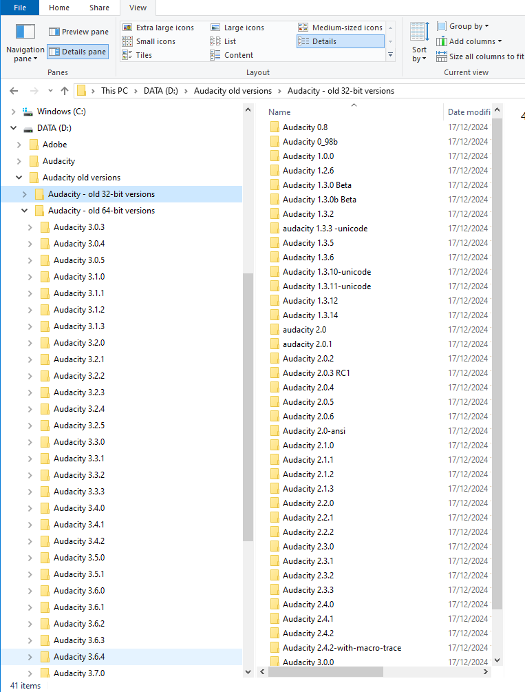

haha
not really - I have most versions of Audacity stored on both my PCs (W10 in Manchester, W11 in Zurich).
I use them extensively for regression testing (and exercises like this thread).
Sadly I have lost the 1.2.4 version of Audacity - the one i started out with that came the the ION deck that I started out with when digitizing my LPs many years ago.
Peter.
