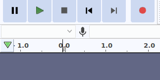

not options available in device toolbar, and in edit/preferences/devices/interface I can’t choose any “host” and a little under that line I can read: Using PortAudio V19.6.0-devel, revision 396fe…(quite long numbers and letters list).

I did that and the version Audacity 2.3.1 is showing. I could also change the interface, there are five options there: classic, light, dark, high contrast and custom. Now I changed back to light which is the one I am used to. I still see some changes though. I guess it’s the update from 2.2.2. to 2.3.1
I guess this is enough for me right now. I wish I didn’t have to make those extra clicks to make audacity work every time I started it but I can live with it.
